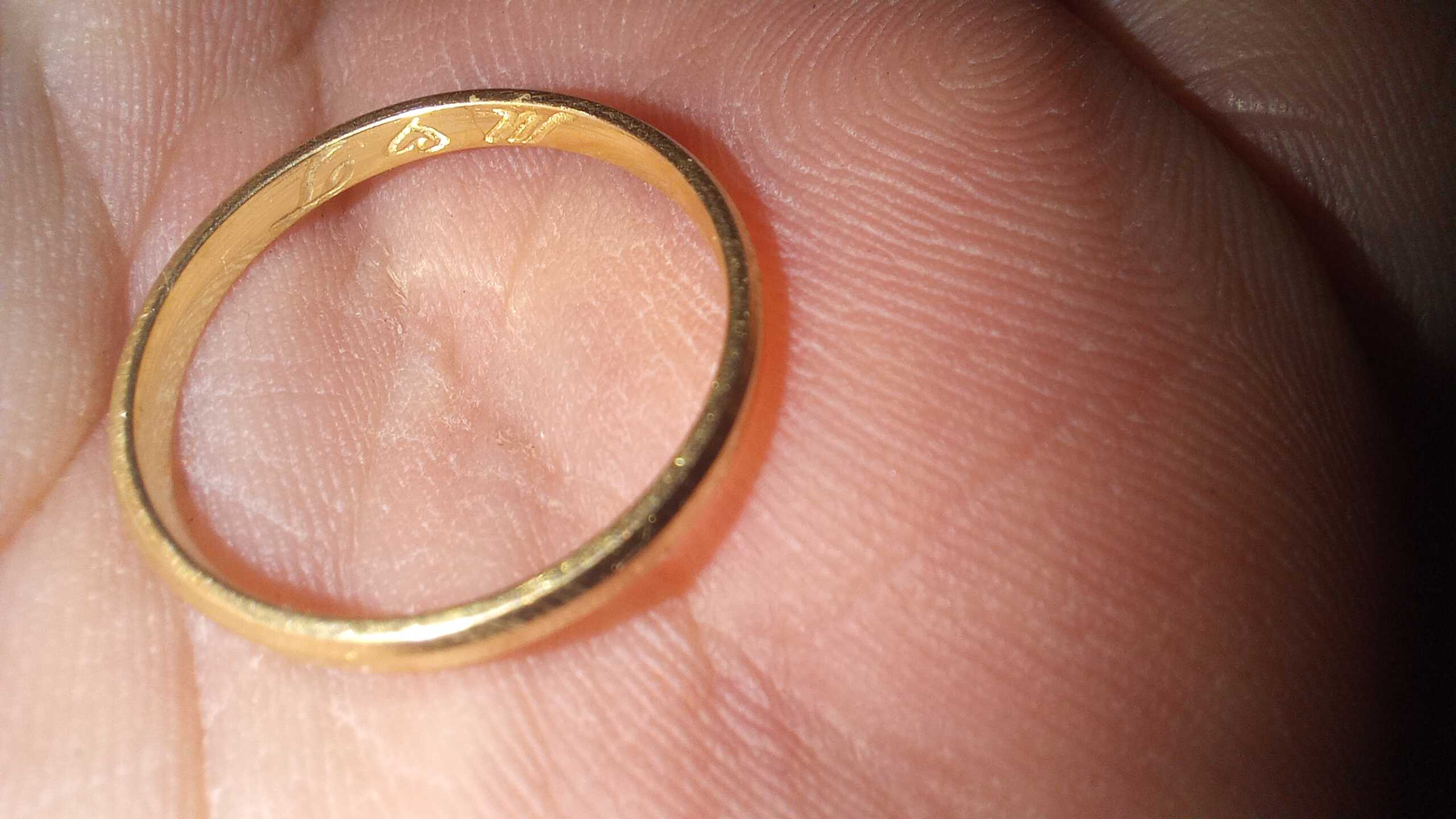

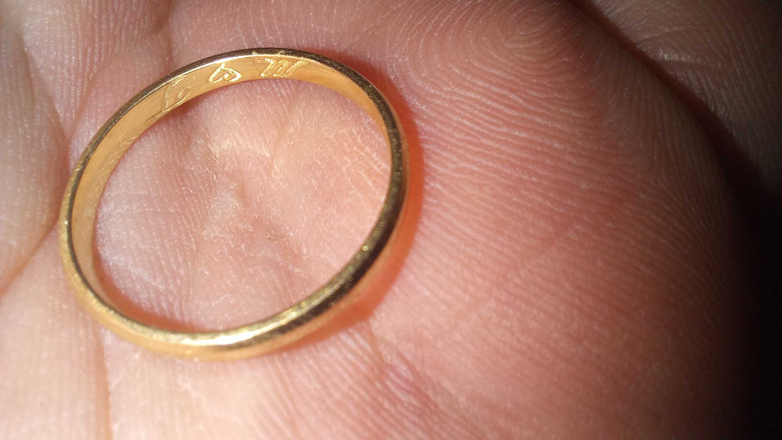

First 18k gold using the NASA-Tom program.
Small ring 18k gold with 1.77g
It was about 5cm deep, it came out in the first dig of the sandscoop.
But I found other smaller items copper jewelry at a significant depth of more than 25cm deep. using M8 coil.
Thanks @NASA-Tom
Ring 18k 1.7g
Ring 18k 1.7g
