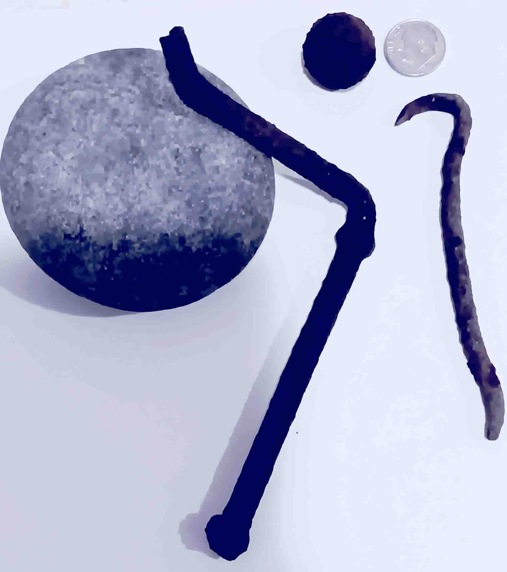

I'm getting the iron I want. Can run that low if you have lots of square nails. I'll bet nobody has hunted with Manticore with upper disc 2 and bottom disc none.
I was hunting in machine gun iron with upper disc 2, lower disc 0,sensitivity 18, recovery 4, low conductor and audio prospecting. Using a slower sweep. It was running surprisingly good with the lower sensitivity. Unmasking is unbelievable at upper disc 2. I am enjoying hunting with the Manticore at upper disc 2.
I'm not finding much non ferrous but I enjoy digging the iron in northern Michigan. In the past I have found a few Indian Heads and Barber dimes in this area. It has been hunted for a few years.
I check my shotgun shells and this is a Peter Target No. 12 with a big P that was used from 1911-1930.
The round iron looks like a musket ball. It's a little spur sticking up and is about 3/4" wide.
The iron tools I don't know what were used for. I like them though. The iron tool has a V at the end.

Sorry didn't show the shotgun shell.

What I thought was a musket ball probably isn't because it's iron.
Re: Tom, running Manticore with upper disc 2
Posted: Wed Jul 02, 2025 2:22 am
Rick..... most cannon balls (including the small ones)...... are IRON!!! But...... round-balls ...... musket balls.....(58 & 69 cal) are usually pure lead.
