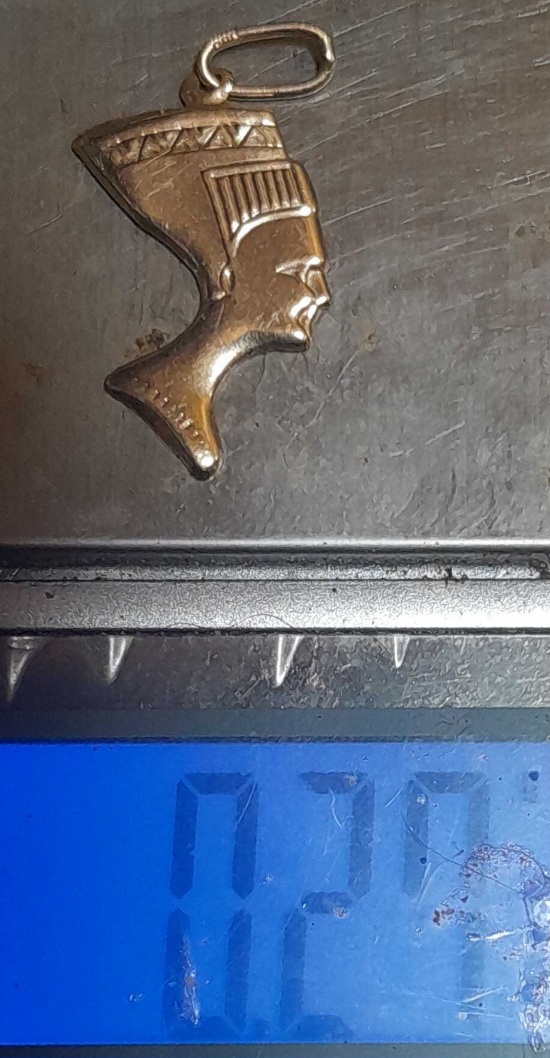

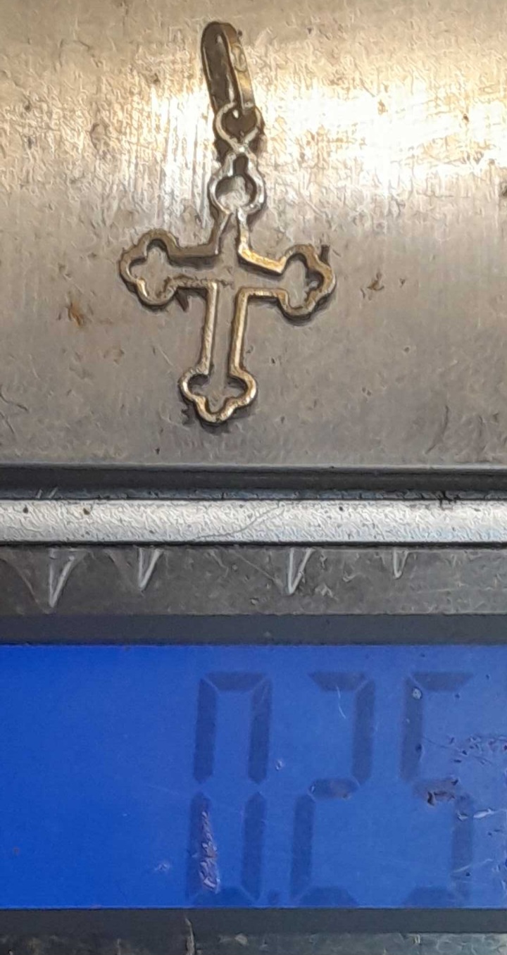

For 8 years it is my job..
Gold getting smaller....also ,got a 0.5g bracelet but only gold platted
2025-3-9 10-11-43.jpg (220.92 KiB) Viewed 23354 times
Posted: Sun Mar 09, 2025 1:22 pm
This is spectacular!!! And you are finding gold that could never be found before. That smaller coil is allowing you to be LESS affected by your black-sand mineralization.

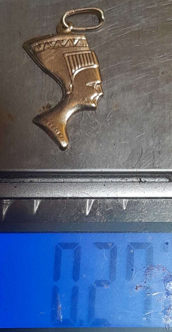

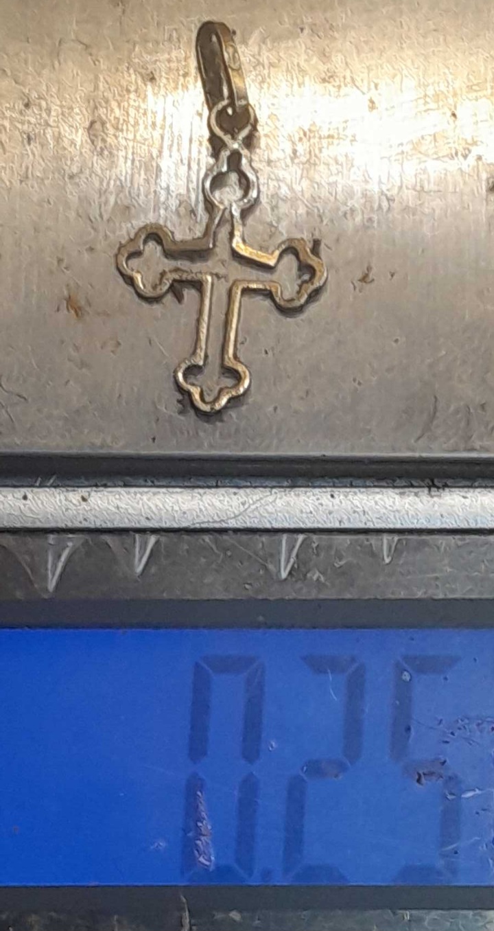

Another 1 TDI....
2025-3-17 12-29-48.jpg (181.57 KiB) Viewed 22570 times
