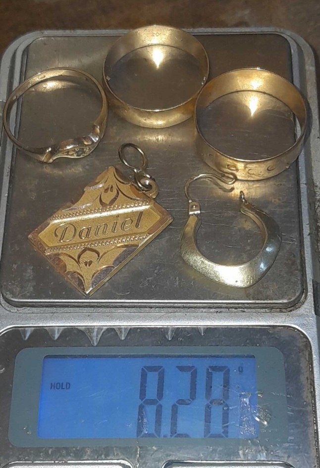

Your making perfect sense,it's just I've run ALL METAL for so long I forgot why...I'll return to my previous settings with sens on 25,this is probably adequate, imbyet to do in water testing with the M8,as itsvto cold an I'm only getting 4 hours before I turn to ice..heresvsome micro goldvfrom past 7 days with M8.

Posted: Wed Mar 05, 2025 1:42 pm
No handicap here..I'm know throwing my 11 in the trash..haha.
2025-3-5 13-35-55.jpg (193.69 KiB) Viewed 21846 times
every day I'm also getting 3 or 4 ,0.5g silver studs or hoops..an today a 1g fine silver bracelet..
The thing is with the M8 it's hitting hard on micro gold,where the equinox would be a soft sound,
The sound seems amplified in prospecting...
Posted: Wed Mar 05, 2025 5:18 pm
This is stunning! Time to quit your real job!!!!
The thing is...... the EQX will not hit on micro-gold; yet, the Manticore (with M8) will. In an air-test; yes, the EQX will detect many of the targets; yet, it needs to happen in the real-World.
LOVE your success!!!! (And the photos)!
