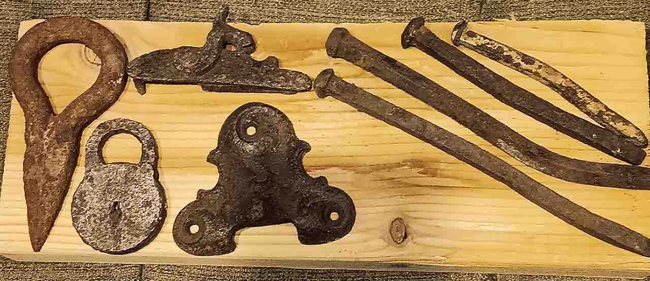

I also hope the Manticore will hit on iron relics like these from northern Michigan.
Absolutely! And I would recommend setting Ferrous Limits - Upper/Lower on 4/3 for starters. You may end up being on 3/2. AND ..... these settings will also unmask another group of non-ferrous targets in close proximity to iron.
If you are hunting iron implements (like the ones in your photo)...... you're going to love the available adjustability of Upper & Lower FERROUS LIMITS!!!
