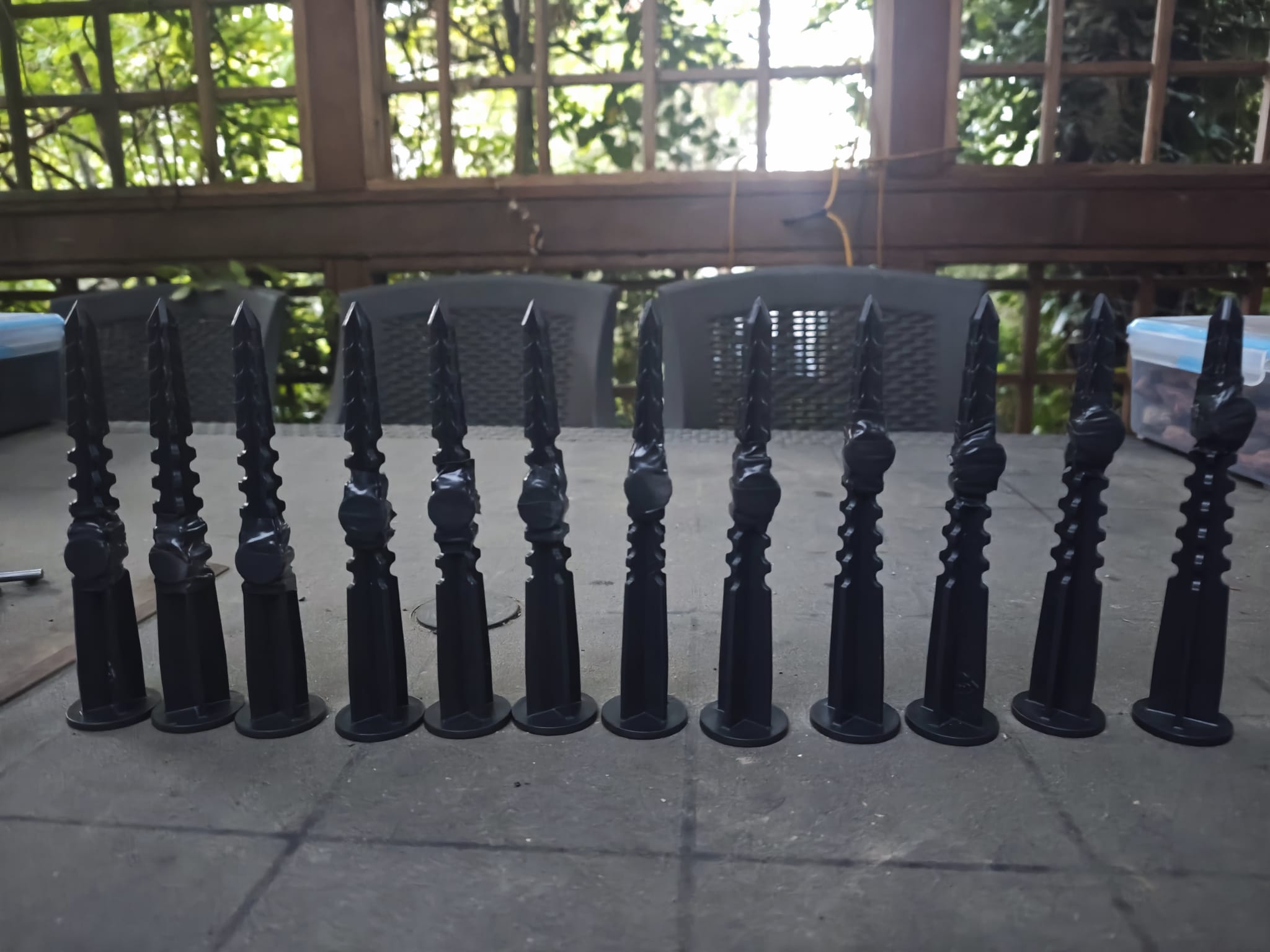

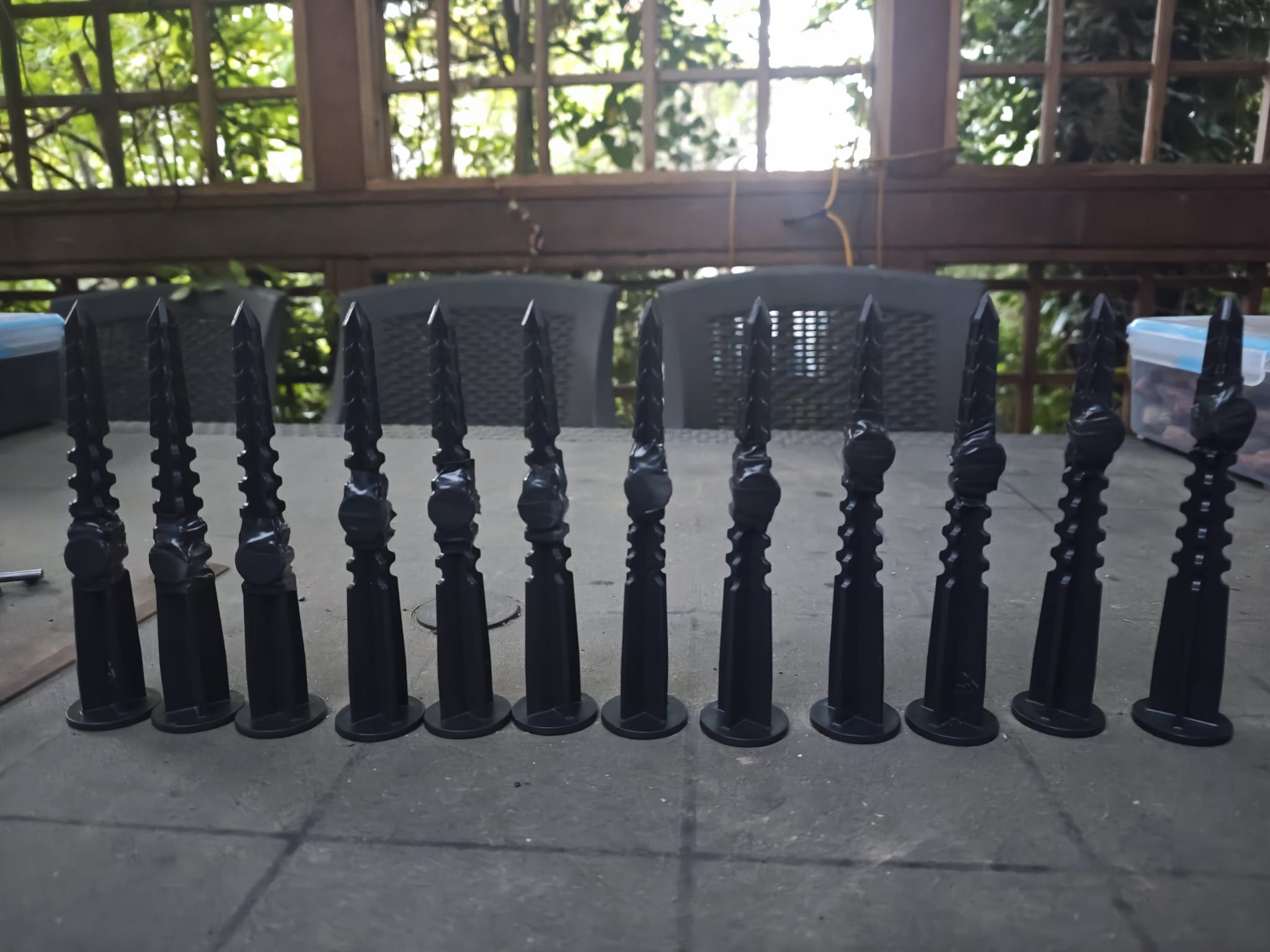

Posted: Sun May 17, 2026 4:26 pm
by EL NINO
Yes, you are right Mr. Dankovski... it will be a system of 12 plastic tubes inserted at different points of the iron carpet..into which for the given testing place..a precisely given and numbered plastic pin with a coin at the detection limit will be inserted. ...for the given tested reference detector..
the plastic pins will be similar to the pins that I use on the 3D separation field with 35 targets between the iron...
Next, one plastic tube of larger diameter /3-4" / will be placed under the iron carpet at an angle of 35-45 degrees...which will be used to test the detector..for deeper storage of the deposit target./cache/. under the iron carpet...
We will see how the tested detectors can cope with this type of target..under the iron carpet..
