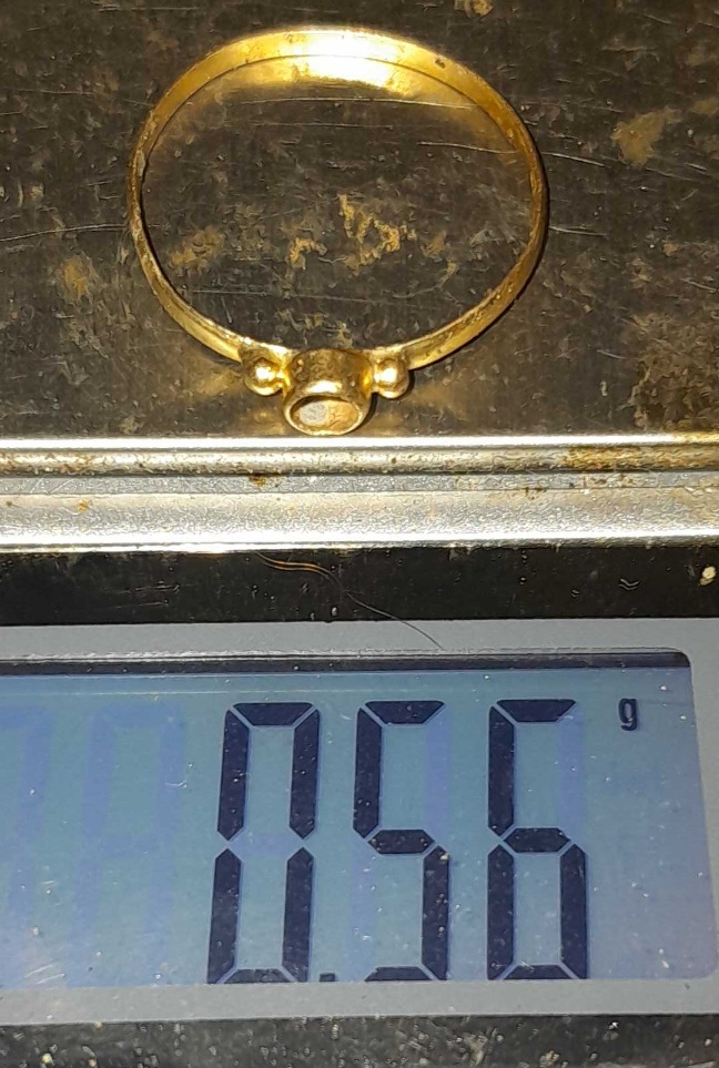

I love the extreem focus that's needed,to hunt micro-gold in moderate black sand,an extreem Mediterranean salt water.
I have progressed to sensitivity 24,the first 20 mins of hunting,I have to settle my swing,otherwise I have 3 types of falsing, bobing coil,extreem SALT,BLACK sand an in some areas, I also have interference from black clay,if it's to close to the surface, after 4 hours my brain is fatigued..

Posted: Thu Nov 06, 2025 8:55 pm
But it's PAYING OFF!!!
