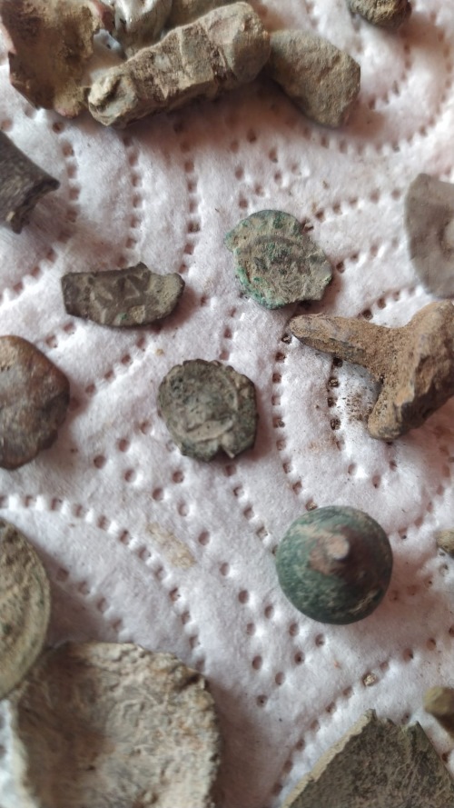

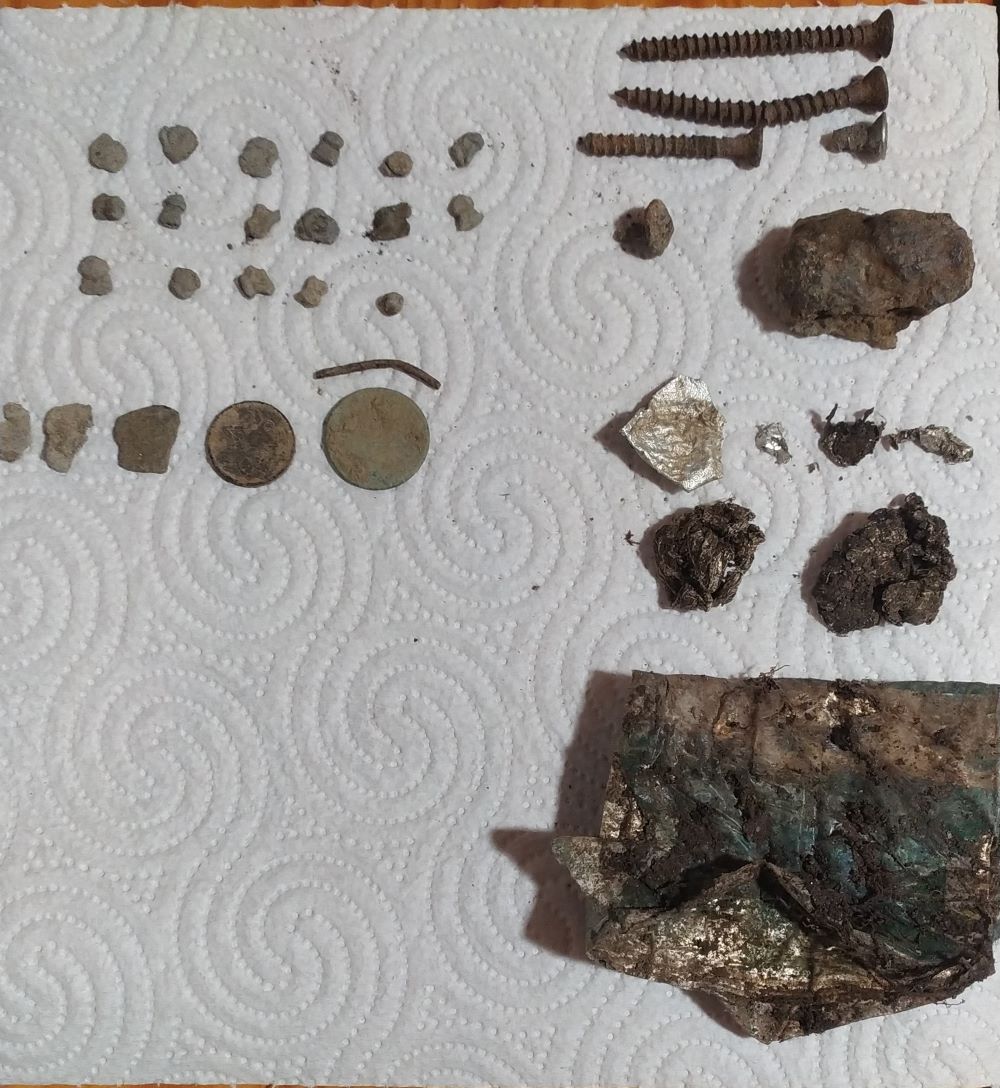

Image 2: Using the Versa Software 3.2nc "Multi Low Conductor" setting, this shows the first sweep of an old stone road; the detection was selective, targeting items with a VDI of 30 or higher.Of course, I also dug up targets with very low VDI readings just to test them—I wanted to see how the detector's software handles those types of signals.
Image 1: The same stone road, but a second sweep focused on targets with a VDI of 13 or higher; the image shows only a portion of the "good" targets (VDI 13+) that were dug up.

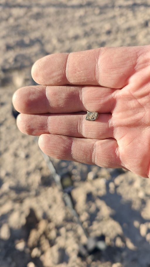

Image 3: From a different location, but it illustrates the point that the old Romans already had the habit of chopping coins into pieces.
- VERSA Multi Low conductor.jpg (134.54 KiB) Viewed 4886 times
- VERSA multy low conductor.jpg (183.4 KiB) Viewed 4886 times
- VERSA 2025.jpg (61.65 KiB) Viewed 4888 times

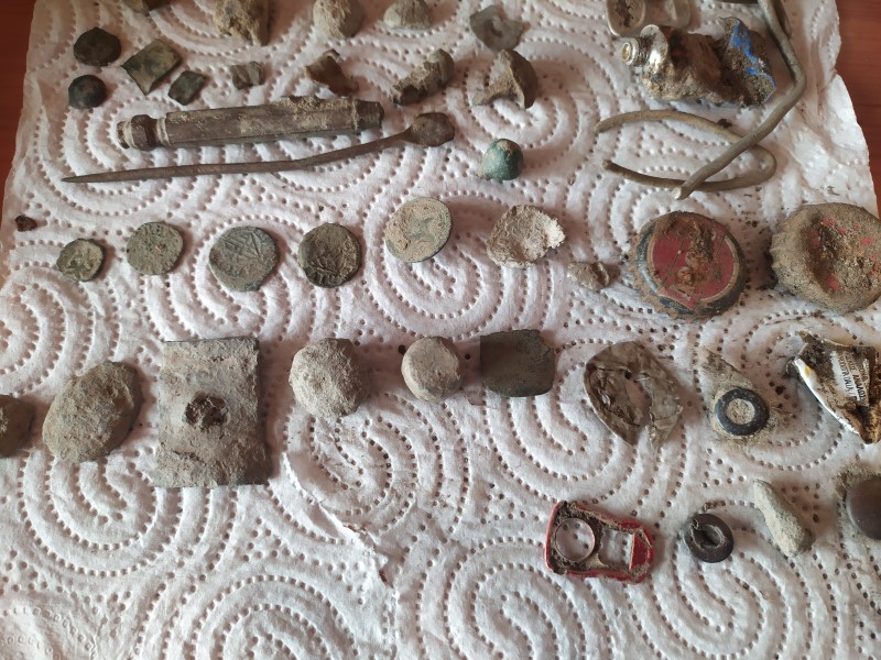

Here is an example of specifically targeting and digging up very low-conductivity items—those with VDI values of 1–15 or higher. It involves the same old stone path shown in the previous images, but in this instance, I managed to detect several targets located beneath iron objects—such as a deep coin with a small iron nail above it, or plated iron 1- and 2-euro-cent coins...
The image clearly demonstrates that Versa excels at selective detection based on specific VDI ranges; consequently, I often focus my searches on ranges above those of small lead targets, concentrating instead on the VDI ranges typical of small coins or coin fragments—specifically VDI +15 or VDI +30 and higher.
- VERSA very low condutor .jpg (185.02 KiB) Viewed 4882 times
