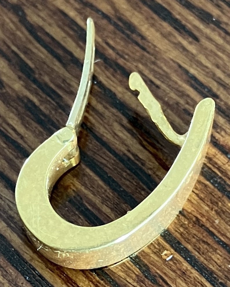

I used the M8 today in the saltwater and was running sensitivity around 23 / 24. Good target on this 18k open earring, weighing 1.7 grams.
The M8 certainly likes the small stuff. Trying to size things to be accepted on the forum
