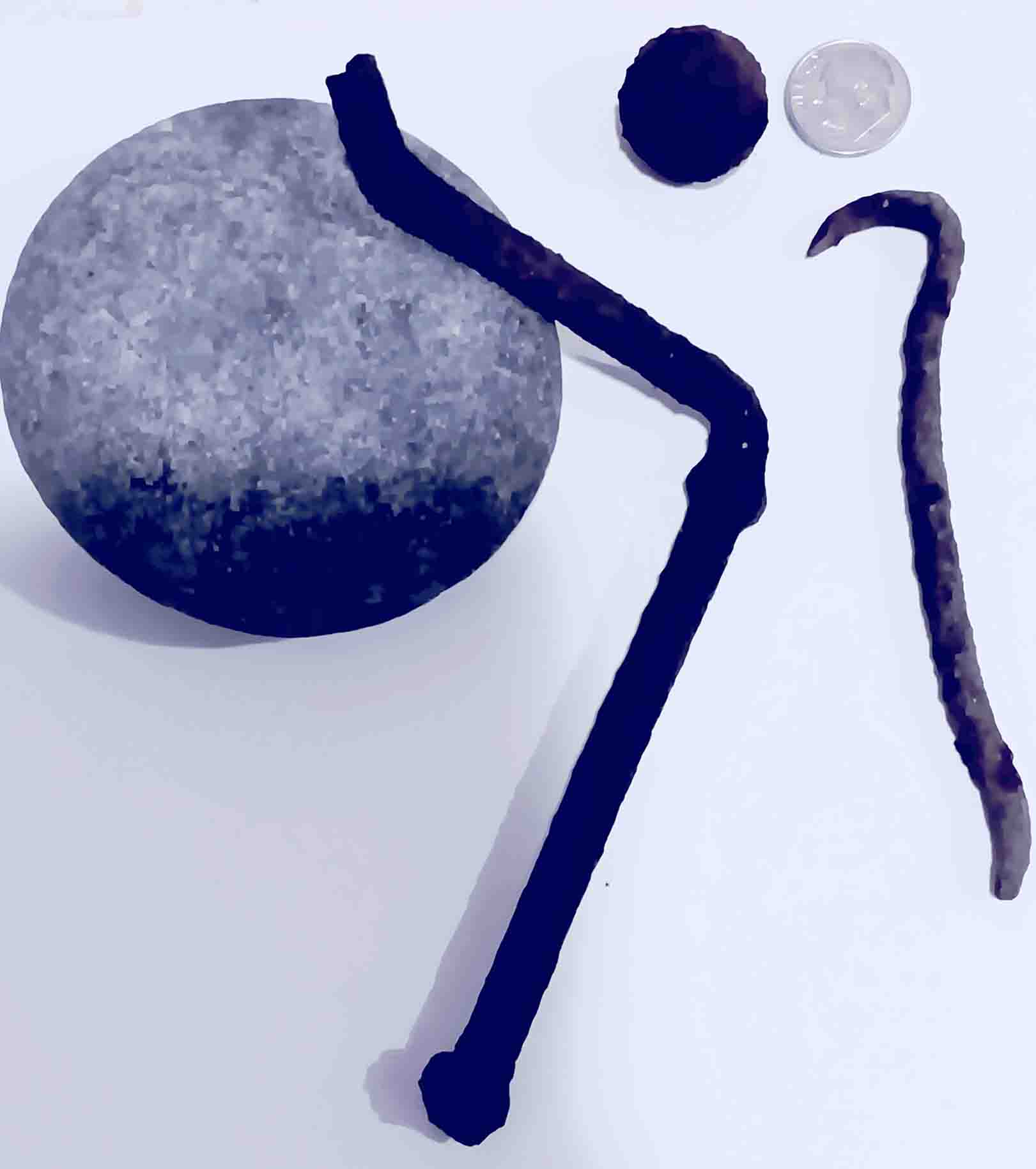

The round iron looks like a musket ball. It's a little spur sticking up and is about 3/4" wide.
The iron tools I don't know what were used for. I like them though. The iron tool has a V at the end.

What I thought was a musket ball probably isn't because it's iron.
Re: Tom, running Manticore with upper disc 2
Rick..... most cannon balls (including the small ones)...... are IRON!!! But...... round-balls ...... musket balls.....(58 & 69 cal) are usually pure lead.
