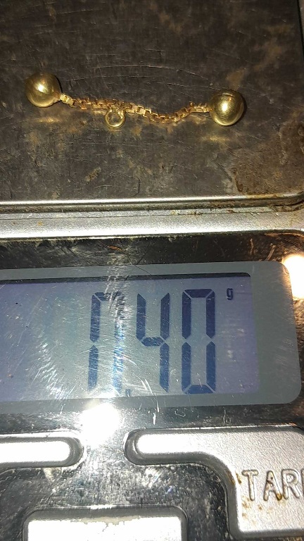

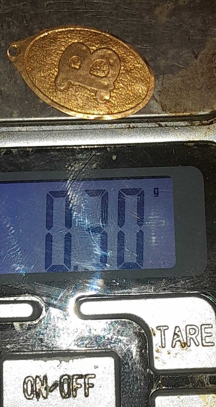

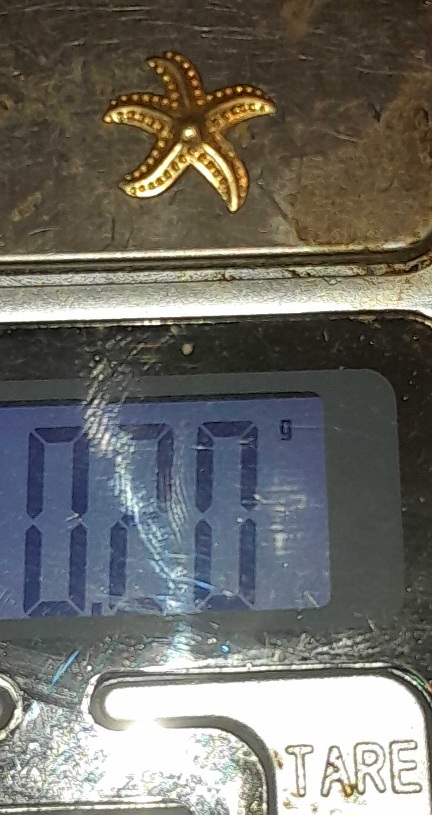

Happy to see you back Tom,an helping with the intricacies of gold hunting, I have continued practicing ZEN an the art of micro gold hunting. Haha. My year end was 72 pieces of less than 1.5g..here's some 2026 pushing the limit of micro gold detection..

au pirata....... Love those finds/photos WITH the weight scale! CONGRATS on those finds! Small gold adds up........... quickly!
