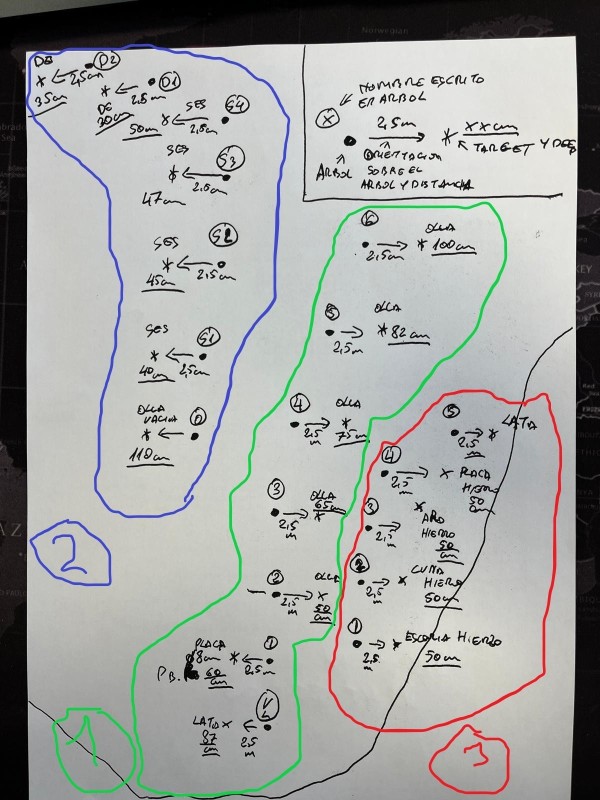

Small correction.... the surface sestertius is placed at a depth of 40 cm....not at a depth of 30 cm...but that doesn't change the fact that it is undetectable...for both CTX and Manticore..
For the sake of overview, I am giving a description of the complete "Old test field" :
blue area... a bronze bowl at a depth of 110 cm and then there are Roman sestertius and Roman denarius coins at different depths..
green area... 2 x control targets of Coca Cola cans at 87cm and 100 cm, then a lead 8cm disk at a depth of 60 cm and then depots 10cm diameter ceramic containers with bronze targets placed at different depths..
red area - contains 5 iron targets placed at different depths.. serves to compare the quality of detector discrimination..
Is this test field very demanding?... yes..but that's about it here goes...
