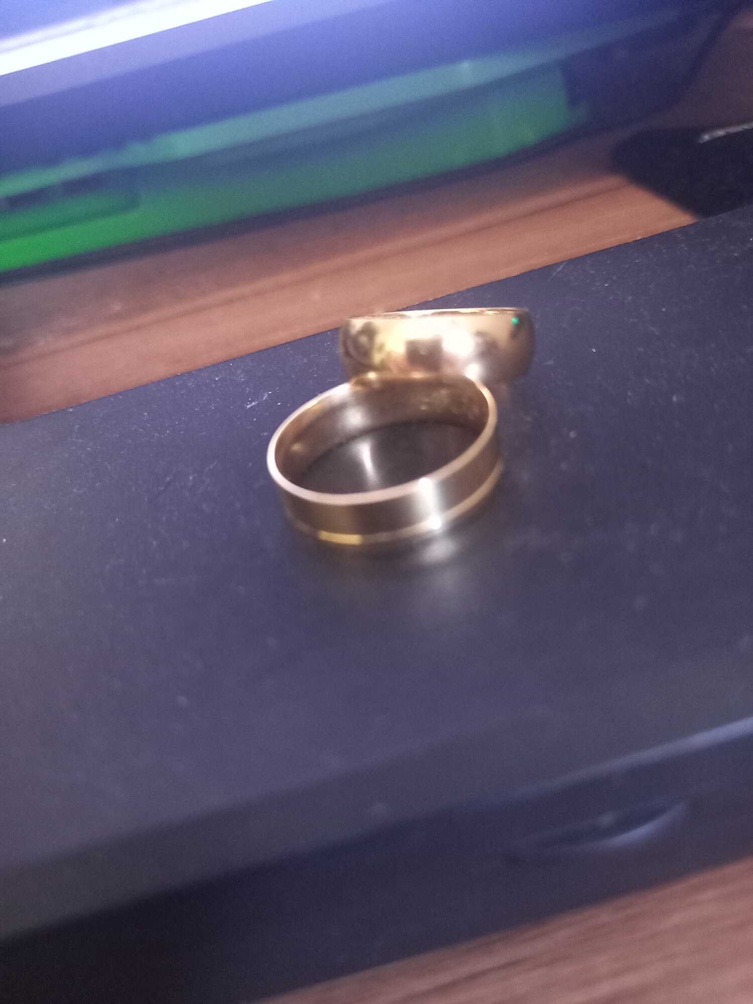

Beautiful ring!
Was this IN the water? (((Which (I believe) is your intended hunting site))).
How high were you able to run Sens?

Good evening (here from Brazil) friend.
Yes, it was in the water(~1m), a beach with lots of black sand and coral remains.
This beach is very problematic.
Even so, I managed to use your program with sensitivity 29-30, strange that regardless of the sensitivity, it kept giving a false signal with ID 1 and ID 2, I was tempted to activate the notch on these IDs but I didn't. After 4 hours of detection with the M8 I tested the M11 but found nothing with the M11.
I think I used too much power (sensitivity) but using too much sensitivity can cause the loss of deeper objects. I started with sensitivity 27 and it got this id1 and id2 signal, I increased it to 30 and it continued, and there were no changes. but I didn't reduce it. What do you think Tom? Should I reduce? Next Saturday I will go there again.
Note: with the equinox 800 on this same beach, the best I could do was use sens 17 on the beach2 with the EQX11 and up to sens 21 with the EQX6

Beautiful photo!!!
Beautiful beach!!!
But...... the beach is so secret...... that no one is there! How could there be any losses (for you to find with a metal detector)!!!???
Yes...... the saltwater will false....with a ID of 1 & 2.
With Sens on 30..........VS...........Sens on 27 = the depth/sensitivity gain is negligible . , . , . , . especially if it increases the numbers/volume of the 'falses'.
BUT........ a Sens of 27 on Manticore..............VS..............a Sens of 21 on EQX.,.,.,.,., is a LARGE performance difference!!! With the Manticore's ability to run Sens SEVERAL points higher (over the EQX)...... you WILL see/experience a formidable performance gain with Manticore.

Secret beach is the nickname that some colleagues gave to this area of Muriú beach - RN/Brazil.
In 2021 we were still in the Covid pandemic, so few people were going out. but this area has a very popular restaurant, especially among newlyweds on a trip.
And the loss of wedding rings is common.
On the day of this photo I took two rings, one 18k and the other 16k with my old equinox 800.
