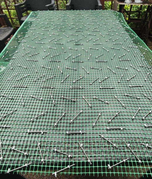

Since I already have a test field with 35 targets for 3D separation,,,, I decided to make another 2D separation test field of the Monte performance Nailboard Test type-XXL. in a really large size...which will allow me to better test my detectors on this type of 2D-2.5D separation situation..
The test will be buried at a depth of 3-4 cm in the ground... so it will represent real detection conditions... in a similar detection situation... The tested targets will be placed in different positions and at the limit detection depth... of course, at the beginning of the testing, each of the targets will be selectable... in order to test the detector's response to the carpet of nails.
I think this will be an excellent test for testing the detector and also finding the optimal coil for this type of detection situation.

Yes.......... this will present superior Fe/iron testing/unmasking abilities. It is my strongest recommendation to have the ability to inject/insert various non-ferrous targets .... THROUGH your carpet of nails..... probably using wooden dowels or PVC pipe. . . . . . . whereby YOU have the ability to vary the depth(s).

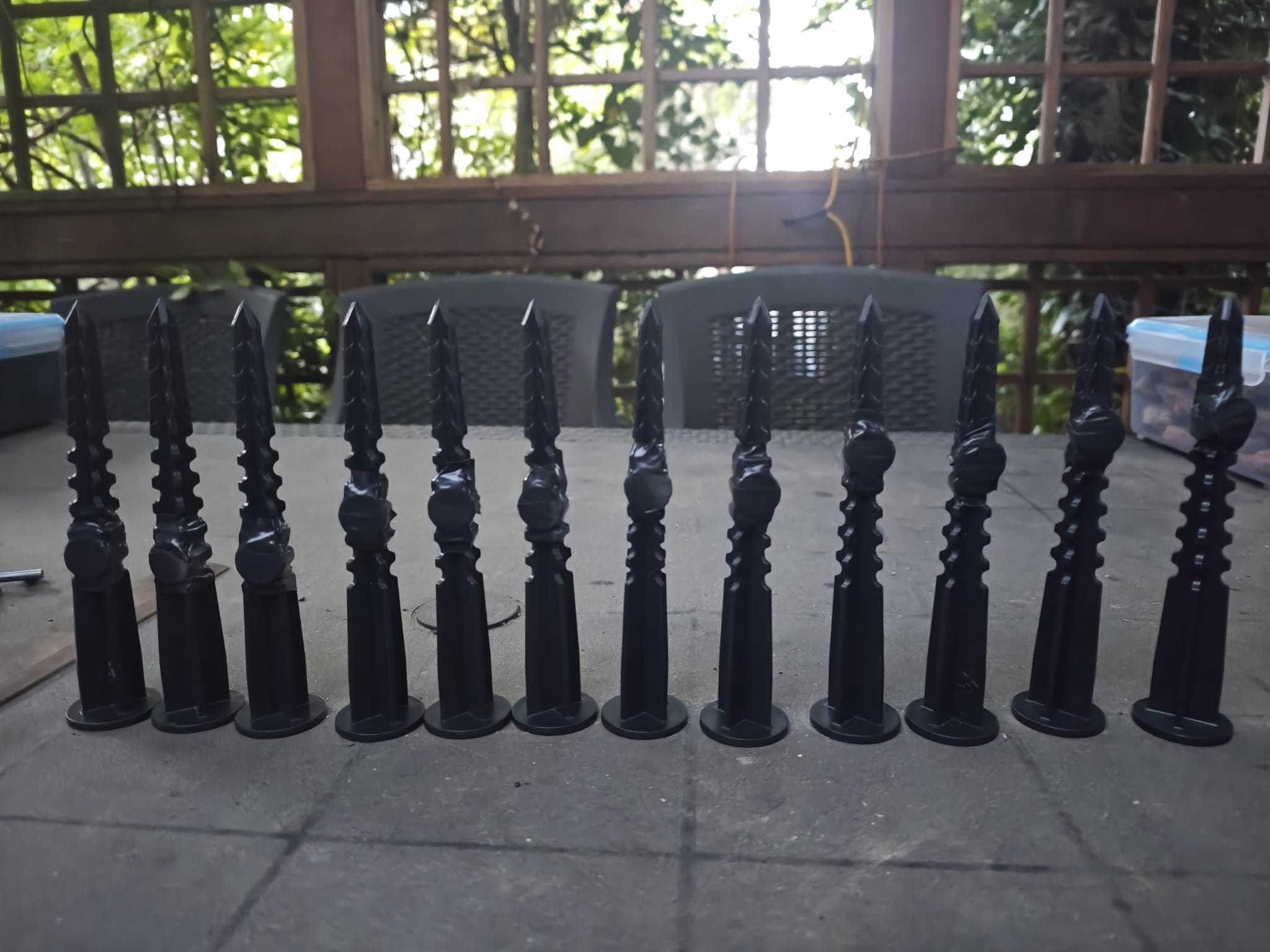

Yes, you are right Mr. Dankovski... it will be a system of 12 plastic tubes inserted at different points of the iron carpet..into which for the given testing place..a precisely given and numbered plastic pin with a coin at the detection limit will be inserted. ...for the given tested reference detector..
the plastic pins will be similar to the pins that I use on the 3D separation field with 35 targets between the iron...
Next, one plastic tube of larger diameter /3-4" / will be placed under the iron carpet at an angle of 35-45 degrees...which will be used to test the detector..for deeper storage of the deposit target./cache/. under the iron carpet...
We will see how the tested detectors can cope with this type of target..under the iron carpet..

Those nails are so thick that........ I question........ if any detector can/could detect anything (coin-sized) under THAT THICK of a carpet-of-nails!
